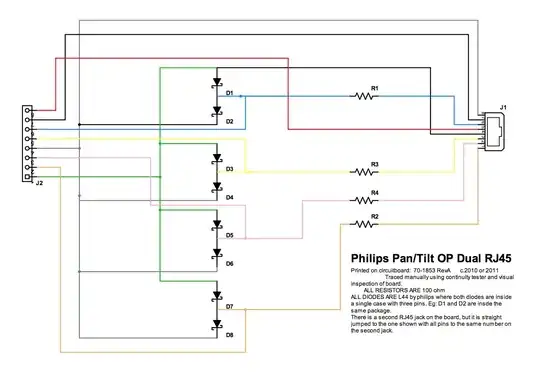

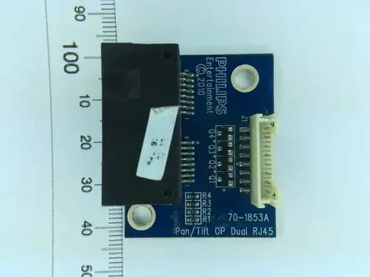

J1 on the RJ45 input board connects to BOTH J2 and J3 on the main board. The two pins on J1 closest to the "J1" label connect to J3 on the main board, and these seem to me to be the power input pins for the board as well as the motor.

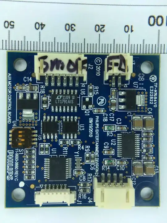

Main board
RJ45 input board
Schematic of RJ45 input board

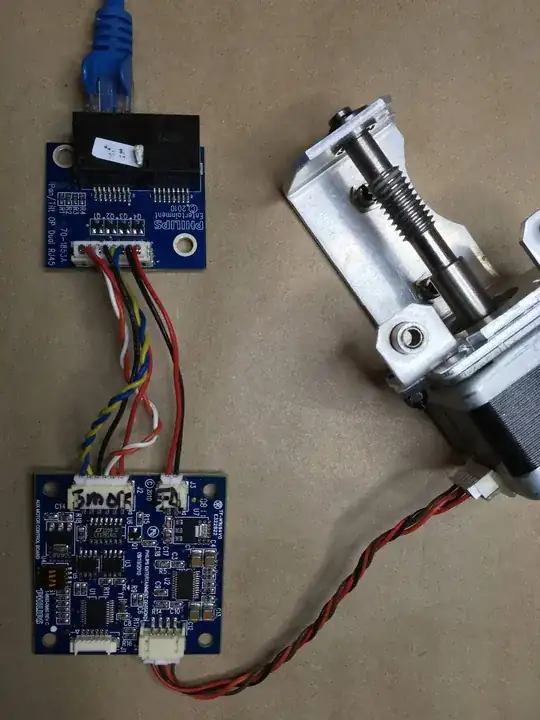

Everything all wired together

  • "5v makes it smoke" - That is unlikely. Are you sure you applied the voltage correctly? Unfortunately your photos are not clear enough to see all the device markings. At a minimum you should identify regulators U4 and U7, then read their datasheets to find out what they can take. For a full understanding I suggest tracing the entire circuit. Then post it here. Also tell us as much as you can about the motor (markings, winding resistance...) – Bruce Abbott Jul 08 '18 at 02:23
  • Using red and black wire colours as polarity indicators, I connected 5v DC to the board. Likely or not- smoking board is what happened. – 111936 Jul 08 '18 at 03:24
  • U7 and U4 are both labeled with "C2" over "9A". Googling the exact term <"C2 9A"> along with many different additional words like regulator, part, chip, part search, printed on it, electronics, component - these all got me NOTHING useful regarding any electronics parts that look like that one does. I am happy to do the work of finding and posting this information, I just don't know how to FIND the data sheet for a thing on a circuitboard if the printed information ON the object gets me nowhere! – 111936 Jul 08 '18 at 03:24

  • Part lookup for the U4 and U7 components: I have tried very hard, but seem to be unable to find anything. The comment at the end of this question seems to explain why - that these tiny parts are very hard to I.D. - https://electronics.stackexchange.com/questions/334128/how-do-i-identify-smd-components-or-how-do-i-identify-any-component – 111936 Jul 08 '18 at 04:59
Nah, don't listen to the naysayers. Actually, I can figure out a lot from the information you've provided. And the high-res images were very helpful. My attempt to answer your questions:
1) Can the power needs of the board be determined by visual inspection? Answer: Mostly. Googling for "stepper motor ic 24 pin" led me to find that U2 is probably an Allegro MicroSystems A3982. Photo here shows marking style and part numbering identical to your photo.
Looking at its datasheet, it uses two power rails: logic rail needs 3V to 5V and the stepper motor power rail can take up to 30V or so. Make sure you read that datasheet.

More reverse-engineering steps are needed. First one makes a hypothesis, and then one tests the hypothesis. So here's the data I think is relevant:
a) There's a black and red wire pair going to 2 pin J3 connector. Guess: probably power.
b) J3 is next to U7. Guess: U7 looks like a typical linear voltage regulator
c) Typically, stepper motors would not be fed tightly regulated voltage and too much current or voltage for regulator U7 to deal with. Guess: J3 probably connects directly to U7 VBB1 pin which powers the motor.
3) If the answer to number 1) is 'yes': How was this determined, in terms a novice might understand?
Basically, you can use the data deduced so far to make a good hypothesis:
a) J3 provides stepper motor power. Test this by verifying that one pin of J3 goes to GND plane, the other pin goes to VBB1 pin of U2 using an Ohmmeter or tracing the pin (you should have posted an image of the bottom side).
b) The label on the stepper motor should give you a voltage rating maybe 12V or 24V or so. If 3a) above is verified, then this would be the voltage you feed into J3.
c) U7 is a linear regulator that powers the logic block of U2 stepper driver IC. Test this by verifying that one of its pins connects directly to U2's VDD pin. If true, then the stepper motor and driver IC gets all its power from J3 connector; just feed in whatever voltage is stated on the stepper motor label into J3.
Other Power
4) There's another red/black wire pair on J2. Black on pin 4, red on pin 1. Looking at your schematic, this is probably 5 Volts.
a) U6 is an LT1791 is an RS485/RS422 line transceiver. This makes sense since there are two twisted pair wires in your cable. Skimming through that datasheet, LT1791 signalling is at 5V, and the RJ45 clamps the data signals to the red/black power rail with the Schottky diodes so it must be that the red/black pair on J2 is probably 5 Volts.
Follow the RX and TX of U6 to J2 connector and you'll figure out which twisted pair is RX and which twisted pair is TX.

There's a glaring error in the RJ45 board schematic and I was really confused until I read that you drew it yourself. The photo shows black and red pair (I assume are power wires) which in your schematic correspond to green and gray lines. But matching up the photo with your schematic, it would mean the diodes on the RJ45 board would get forward biased and short circuit the 5V. So either your schematic is not quite right, or the black wire is carrying 5V and red is GND which is backwards from convention.
Other Tidbits
U1 is a Microchip PIC18F???? something 8-bit microcontroller. It has the Microchip logo and the "PIC18F" is just barely readable. It has a crystal on pins 17 and 18 so you can use that if you want to confirm it is a PIC.
U4 is probably another linear voltage regulator. It could be they are running the PIC at 3.3 Volts. You can trace that wire on the circuit board, but not really relevant here.
There's a whole bunch of vias around U4 and U7. But it seems like the PC board layout guy/gal forgot to put a polygon fill to tie the heat tab of U4 and U7 to those vias. Duh.
