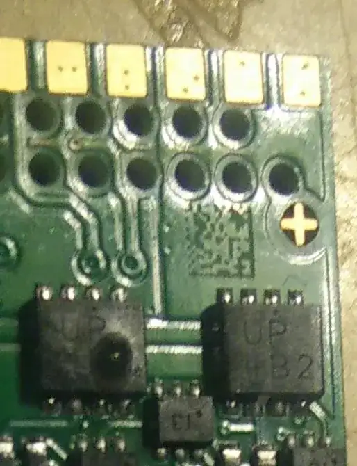

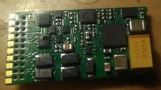

Acts probably as a driver to power the motor. There a two of this kind on the board. One burned, the train drives only in one direction.

                    I can't tell what I see here. It might as well be a fet or transistor. Can you post a sharp photo of a larger area of the board the chip is used on? Or trace some of the signals going to it, that would certainly help matching pin-outs. – Jeroen3 Oct 26 '17 at 08:10

        I searched ebay for "darlington dfn8" and found a "AON 7200" chip. A 30V N-Channel MOS-FET, where 4 pins of one side are internally connected. So I have to measure if it is this type. Tecnically it might be that...
                    Draw circuit diagram basing on the board layout and component pinout and share it. People will be able to give you better idea then. – Anonymous Nov 02 '17 at 21:34
