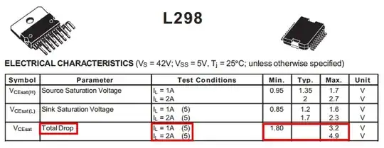

What about the L298? It's got a nice big heat-sink whereas the L293 and SN754410 are regular-looking chips. Here's what the volt drop (losses) look like: -
It's the same story - for a 1A load, you can expect to lose up to 3.2 volts and, what you thought might be 6V across your motor, is at best 4.2 volts and at worst only 2.8 volts.
Clearly none of the devices listed are suitable for low voltage applications where the motor might be expected to draw in excess of 0.5 amps.

  • I have been using both the L298 and L293D. I would recommend the L298 over L293D. Practically speaking, the voltage drop was never below 1v for 1 Amp 6 volts motor. While on the other hand, the L293D had way worse voltage drop. – Adel Bibi Apr 30 '14 at 21:47
  • @AdelBibi in a full H bridge configuration, the spec says that the minimum volt-drop is 1.80 volts - I don't see how you can say it was below 1 volt unless you mean this for a half-bridge configuration? – Andy aka Apr 30 '14 at 21:52
  • I have the full bridge. It might be because I'm using a module that might have a certain ciruitry that helps improving the voltage drop. I'm using one similar to this: http://www.ebay.com/itm/Dual-H-Bridge-DC-Stepper-Motor-Drive-Controller-Board-Module-L298N-for-arduino-/251080674810?pt=LH_DefaultDomain_0&hash=item3a75930dfa – Adel Bibi Apr 30 '14 at 21:56

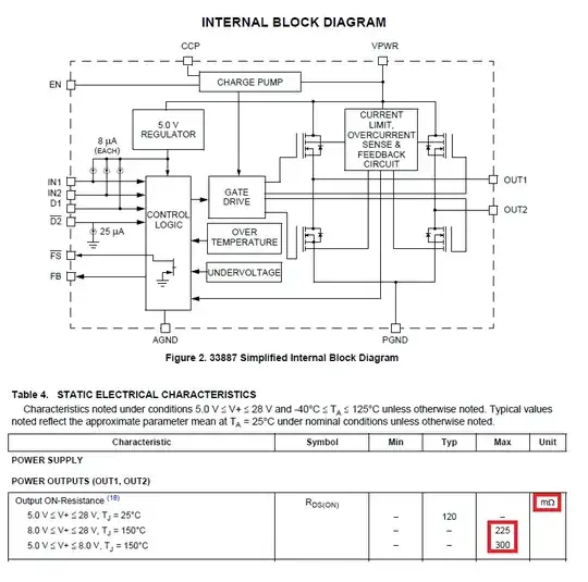

There is also the MC33887 from Freescale (formerly Motorola): -
It has on resistances in the low hundreds of milli ohms too.
