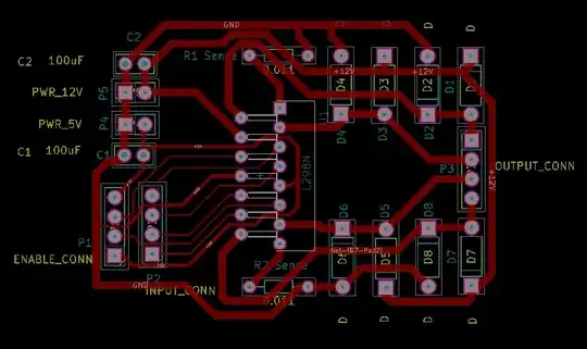

I'm decided to finally make my motor driver boards but I'd be happy to have some feedback as it's my first PCB design.
It's mostly based on the datasheet of the l298n chip. So there is nothing much here.
R1 and R2 are supposed to be shunt resistors but in my case I can probably just short them as I don't plan to measure power.
I'm not sure yet about which diode to use. Most of the design I already saw for the l298N seems to use common diodes such as 1N4001 and such.
I was planning to use 1N5822 diodes for my own design. I do have 1N4004, 1N60, 1N914 diodes in my possession.
PCB Update: Updated PCB Schematic

Also, the tracks have the default KiCad size (0.25mm) for most except PWR lines with 1mm width. I'm planning to etch the board myself.
    Your diode choice may not be the best. These have a very significant reverse leakage current of several milliamps; about a thousand times that of the 1N4004 you mention also having. And definitely don't use the 1N60! That's a germanium diode, which usually have very high reverse leakage currents, even worse than Schottky diodes. Not to mention that they're obsolete and hard to find; those practically belong in a museum. – Hearth Nov 22 '18 at 13:52
  • Hm, perhaps I was wrong about the bad reverse leakage; dug up an ancient datasheet and the rating isn't that bad, certainly not worse than that Schottky one you mention using. Still, though, it's a very obsolete part. – Hearth Nov 22 '18 at 14:00
  • I would call R1, R2 current sensing resistors. If you don't really care worst-case scenario (short-circuit), then you can ignore and short them out. – Long Pham Nov 22 '18 at 14:16
  • Thin traces connect R1, R2 (0.011 ohm) to ground. Try to connect these high-current paths with larger width of copper. +12V paths also carry large currents that might benefit from wider traces. Single-sided board with no plate-through holes? If so, pads should be large diameter so that they don't de-laminate from strain on connectors & large components. – glen_geek Nov 22 '18 at 14:28
  • As @Andyaka already hinted at: I would not use the L298 for any new design. There are much better IC's these days, based on NMOS with a charge pump and including the fly-back diodes. (L6201:Vds on 300mV) – Oldfart Nov 22 '18 at 14:36
  • @glen_geek yeah single sided no plating. I'll check what I can do to increase pad size. I unfortunately cannot increase much the diameter in some cases but can try to make some longer. – Loïc Faure-Lacroix Nov 22 '18 at 14:40
  • @Oldfart that's quite possible. I'm not planning to order new parts anytime soon as I'll be moving around the world soon. That said, this design is more to free my proto board and I plan to make h-bridge board based using high current mosfets later. – Loïc Faure-Lacroix Nov 22 '18 at 14:48

    The very decision to use an L298 makes the design fatally flawed. Start over with an FET bridge. – Chris Stratton Jun 14 '20 at 01:25
    Maybe move R1 down a bit to make space for the power tracks. Remember you’re paying for the copper and Ferric chloride so etch away only what you need to. – Frog Oct 23 '22 at 20:07
I suggest you read the datasheet, before you start a design. The datasheet is the source of all good information. First of all the datasheet states that the diodes must be Fast 2A with VF <1.2V@ I=2A and the trr< 200ns. This is the first step for a good design. R1 and R2 might need to be larger, as they are the sense resistors for the driver. this means that all of the current that goes through your load goes through these resistors.
The traces that will required to be beefed up, are the ones from the following pins: 1,2,3,4,13,14,15. Depending on the current of your load, the connectors for the power input and motor output might need to be bigger.
Make sure that you have taken into account the power dissipation of the L298. Depending on the load, you might need a heatsink.
Layout wise, I would make the pads of the L298 Oblong, so that you will have better chances at not ripping out the pads while drilling the holes, and give a more solid base for the solder joints.

  • Wouldn't it be better to drill holes before etching? That said, if it's necessary I can also electroplate the copper clad to make it thicker. – Loïc Faure-Lacroix Nov 22 '18 at 14:53
  • In commercial manufacturing the holes are drilled before etching, but generally in home etched PCBs this is done at the end.
    There are two simple reasons for this, first of which is knowing where to drill, as on a solid plate of copper, it is close to impossible unless you have a CNC, but most people don't. Alignment of the traces to the holes, now becomes critical, and you also risk to over etch inside the holes. Electroplating might help with that.
    – Elmesito Nov 22 '18 at 14:59
    Etch first, drill later...otherwise copper will etch away from the drill hole, making soldering more difficult. It is a good plan to design a pad with a tiny diameter hole that is used as a guide for your drill. – glen_geek Nov 22 '18 at 14:59
  • @glen_geek Yes, It makes a lot of sense, etching a little point might help center the bit in pad. – Loïc Faure-Lacroix Nov 22 '18 at 15:08
