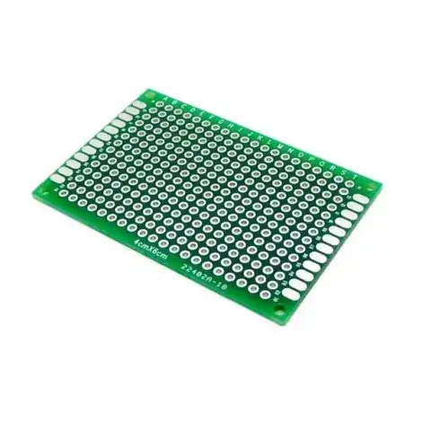

_I'd rather buy some module, because if I need to build my H-bridge, I'll have to do it on boards like this: Board Example
Board Example

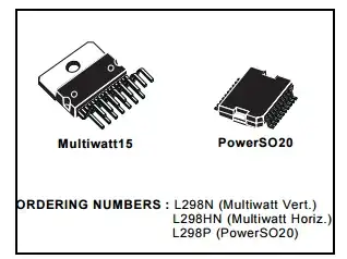

For an electronic part, always refer to the datasheet. Note that the link I gave is from ST Microelectronics, the manufacturer and not other alternative source (Sparkfun, Arduino forum, etc). Reliable source of information is important in engineering.
Right a the top of the datasheet, you will find this
L298 is the name of the circuit, but it does not refer to a orderable part number. L298N is a part you can order and it refers to the Multiwatt15 version of the L298.
As for the device that burned. You are right, maximum absolute ratings are 50V, 2A continuous, but these are the very high limit. You should stay away from these value unless you are sure that you need to.
Even though the device can supports 50V and 2A, it doesn't mean it can dissipate the heat it produces. If you look at the voltage drop of the transistor when saturated at 2A, you will find : \$V_{drop} = 4.9V\$. Which means \$P=4.9V*2A=9.8W\$. 9.8W of heat needs to be dissipated by the device, and that is only for a single H-Bridge, the chip has 2!.

In other word, the device can drives 2A if you can dissipate the heat it produces. To do so, you will have to add a heat sink. The physical case of the L298N is designed to be mounted on a heat sink, that is why there is a hole and a metallic back plate.

I know you said that electronics part are not easily available where you are, but I would say that a voltage drop of 4.9V is not very good performances in my opinion. If you can find another H-Bridge that creates less heat, that could be a good thing. Making your own H-Bridge is not very hard, but yes, you would need something to hold the aprt together, just like the board you showed.
