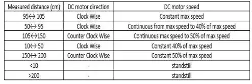

I am making an Arduino project in which I have to control speed of DC motor with an ultrasonic sensor.
I have written an Arduino program to do this work but unfortunately my motor only rotates in forward and backward direction and when it comes in specific range like (50-95),(105-150) where I have to decrease the motor speed by 50 and 40 % then the motor only makes some noise - it does not rotate.
