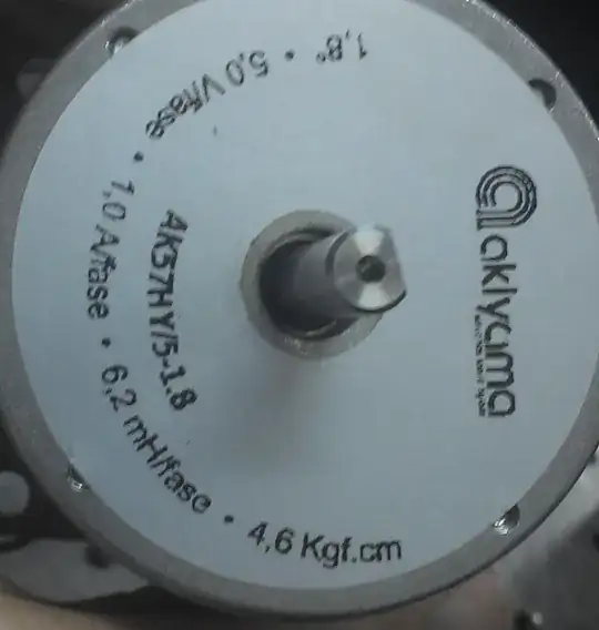

I'm trying to control a stepper motor with Adafruit Motor/Stepper/Servo Shield V1, Arduino UNO and a 19V/5A power supply. The motor uses 1A/phase making the driver overheat.
Is it possible to use the two stepper controls from the driver in parallel to control only one stepper and avoid overheating?
