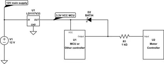

One may be tempted to use the old diode to VCC trick as an alternative to the TVS, like this:
schematic
simulate this circuit
In theory this works just as well, since your 3.3V is strongly regulated, and the BAT54 schkottky diodes at 10mA haven't got a very high forward voltage drop, so the input will likely not see much more than the 3.6V peak we had just before.
BUT: You must always look at what happens in all cases.
Let's say your MCU only uses 5mA on average, now what happens when the motor driver shorts to 12V on only one pin (let alone all of them):
the 1kOhm resistor has 12V on one side, and the MCU drains on average 5mA, and the regulator is only designed to give current, not take it (in most cases). So the resistor has on average no more than 5mA running through it, because any more current can't go anywhere.
So the voltage drop, according to Ohm's law across the 1kOhm resistor can not be more than: V = I * R = 0.005A * 1000 Ohm = 5V, which leaves 7V at the anode of the diode, which makes for 6.5V-ish on the MCU. I think it's very likely it will not enjoy that very much. Nor will the voltage regulator, even if it manages to compensate it down to nearly 3.3V.
And that's using the average MCU current. Not even the lowest possible. And you should always use the lowest possible in this "worst case" estimation, because at the lowest current you have the highest peak voltage.
So if you do go by that trick, as many sites still may suggest, you first need to very carefully consider the resistor value and the lowest current use of your digital system and often these days you will soon figure out that the resistor needs to be too large, or that the other risks are just getting too high. Thing is, this trick comes from the days boards had so many chips warming up that 1A or more on the 5V VCC rail weren't uncommon in professional logic systems.
