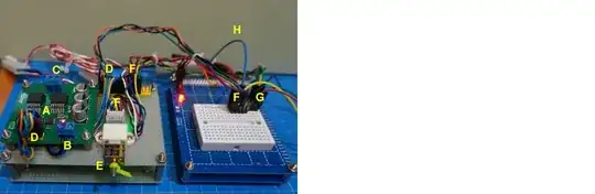

I'm running series of experiments using a 6V DC motor. I'm using desktop DC power supply to power the motor and regulate its speed and everything works just fine, the setup has been running for months.
Now I need to use Arduino motor shield to power the motor and run a particular control sequence (involving motor speed, direction, brake). Arduino is powered by 9V DC supply brick (from an 110V outlet), and delivers approx. 8.5V on its outlet power pins. Once I connect the motor the voltage I read on the pins is approx. 6.8V using my multi-meter. I cannot measure the current, once I connect the multi-meter the RPM drops dramatically, I guess I'm affecting the circuit somehow.
So far i have been using Arduino's PWM control successfully but only for motors rated for voltage equal or greater than that of the power supply. This time I'm conscious of the max. voltage/current on/through the motor. I understand that PWM will reduce the average voltage but my understanding is that the motor will see the full voltage only at shorter intervals. Will this damage the motor? Playing with different PWM values I was able to get the same voltage as previously from bench DC power supply (say, 3V) but the motor noise is quite different. Motor is much louder and it sound as if it's struggling to work. I'm still measuring the same average voltage of 3V on the motor's power pins. I'm afraid this will reduce motor life or burn it completely if I continue letting 6.8V (8.5V?) directly onto it. How safe is to continue this operation?
I also saw a good discussion on regulators here on StackExchange. If PWM is not suitable, should I try a voltage regulator? Ultimately, what I'm trying to achieve is for motor to change the speed/RPM but also the direction - not sure if I can pull this off with the regulators. What would be your advice for this application?
Please don't mind if I used inappropriate terminology - I'm just a daft mechanical guy trying to figure the electrical part of how I can run this safely. I'd appreciate any input. Thanks.

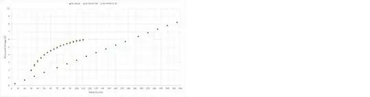

EDIT: This is to provide info on PWM frequencies/mark/space ratios. I hope a chart is OK, it might be easier to explain.
The way Arduino works is you set PWM via a byte, so sending a value between 0 and 255. 0 will let no marks through, 255 will have no spaces.
I plotted here the voltage measurements across motor contacts when: a) no motor is connected, b) when motor was connected and rotation was set to CW, and c) when motor was connected and rotating CCW. CCW rotation voltage should have "-" sign in front but I plotted it this way to be easier to read and compare. Motor had no mechanical load on it.
For the motor, I stopped plotting PWM at point when I almost reached the rated voltage. I'd like to run the motor at minimum of 2.5V, and I'm interested to know how high I can go. Also if this minimum is OK or not (so far it worked just fine off of a bench DC supply).
I hope this makes sense and please let me know if there's anything else I should check and provide.

A.2 - The OP's Average Voltage vs PWM Measurements and Chart
v vs pwm chart
The average voltage measurement used by the OP is not very useful for controlling DC motors for many reasons: (1) DC Motor speed is not linearly proportional to input voltage or current (Appendix B). (2) The DC motor's Voltage, Current, Torque, Efficiency relationship (Appendix B) is complicated.

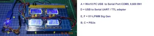

  1. Manual UART XY Signal Generator (Arduino/Rpi PWM, NE555, PCA9685)

xy uart sig gen

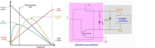

The focus will be on PWM speed control on DC geared motor, using a power MOSFET and a PWM signal generator.

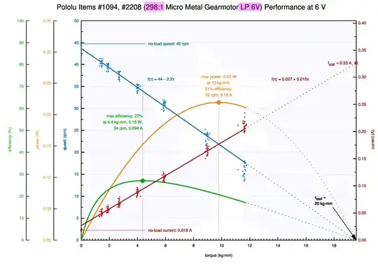

(21) Pololu 1000:1 Micro Metal Gearmotor HP 6V 31rpm, 70mA, 12kgcm, stall 1.6A - US$24

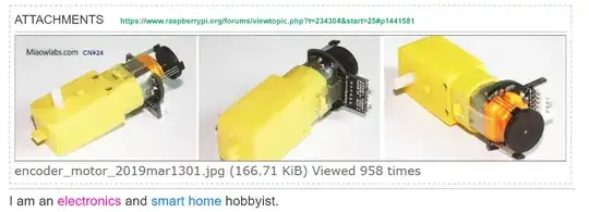

(26) TTM1 1:120 gear DC motor with AB encoder (6V, 200rpm, 3.2kgfcm, 960 pulses) - MiaowLabs ¥30

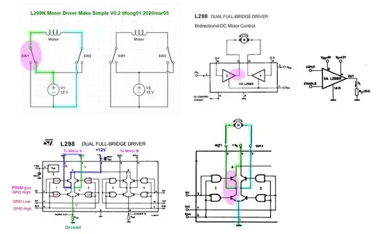

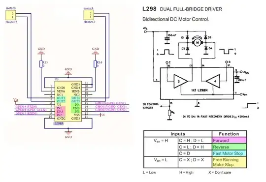

Appendix A - L298N Schematic and Operation
l298n 1
l298n 2
l298n 3

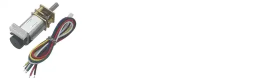

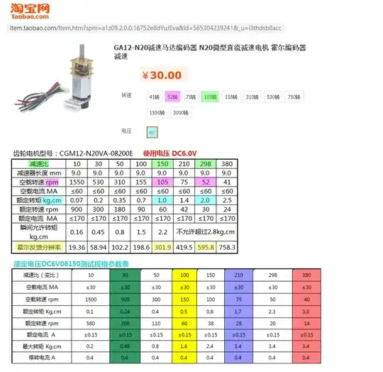

Appendix C - GA12 N20 Gear Motor with Hall Effect Encoder Specification
(20) TaoBao GA12-N20 Gear DC Motor with Hall Effect Encoder - ¥30
n20 motor spec
n20 motor spec
n20 wiring
ga12 na20 order

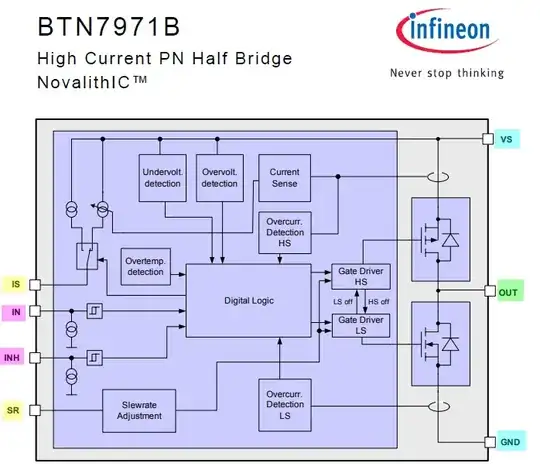

Appendix E - BTN7971B Datasheet Summary
btn7971b 1
btn7971b 2

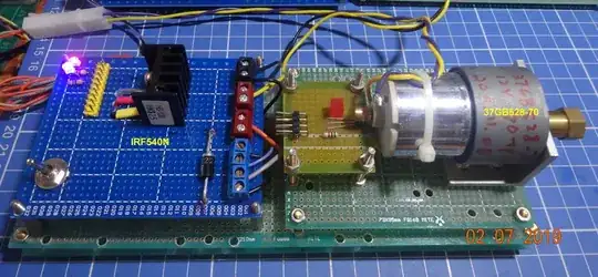

Appendix G - N20 DC Motor PWM and Hall Effect Quadrature Encoder Test
n20 pwm hall test 1

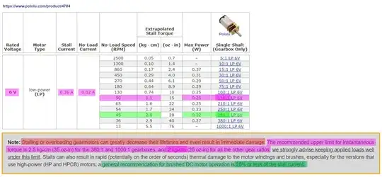

Appendix H - NA20 Motor PWM and Encoder Test Preparation Notes
na20 spec

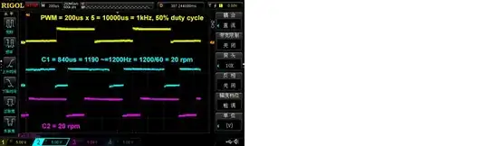

Appendix I - TT130 6V Quadrature Encoder Test Results
Motor TT130 6V ~= 48 rpm
tt130 sped 1
tt130 speed test
Appendix J - N20 Quadrature Encoder Test
NA20 test 1

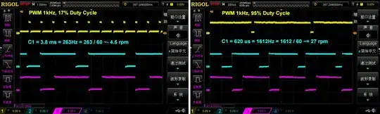

(a) I set 1kHz PWM signal to 100% duty, and also direct 6V PSU to check the motor speed. I found in both cases, the encoder output C1 is
600us, or 1000000/600 = 1666Hz, or 27rpm.
In other words, the motor driver does not seem to have any volt drop causing a reduction of motor speed.

  • I have been playing with toy motors TT130 and GB37. Your NA20 motor is too small for my big hands to handle. I remember I once carelessly fried two NA20 motors, by wrongly using too long screws, crashing the gear box, and too heavy loading sticking things. Perhaps I can search my junk box for any NA20 motors left over and tried it again. Ah, bed time. I call it a day. So see you on Sunday or Monday. Cheers. – tlfong01 Jul 17 '20 at 14:32
  • Oh, I see what you mean - if I understood correctly, you are saying to use the magnetic rotary encoder (my motors have them) signal to monitor the RPM and control the PWM based on that? I haven't thought of it. Perhaps because voltage regulation was so readily available. Good thing I asked! Do you have any recommendation on calibration procedure? What I mean, I don't understand the part of keeping the voltage fixed at 3V and RPM change via PWM - on Arduino voltage changes as I change the PWM value... Also, how do I keep tabs on excessive voltage? Enjoy your weekend and thanks again! – mk1138 Jul 17 '20 at 19:48
  • P.S. My actual motor, my actual magnetic encoder. I tested encoder just briefly a couple of times when I got the motor but I was getting some nonsensical readings. So I moved to capturing the RPM via high-speed camera. I need to revisit the encoder readings and try to pair it with the actual RPMs I observed. – mk1138 Jul 17 '20 at 19:53

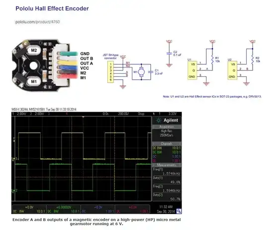

  • Yes, the magnetic/Hall effect encoder is very useful to measure both speed and position. You can use Arduino GPIO pin to detect the A, B signals to deduce speed, direction, and distance. There is some confusion about motor power supply, eg 6V, and PWM power. For example, if you are using the L298N motor driver, the L298N power supply Vcc is 6V, but if you set PWM duty cycle to 50%, say, then the "average" voltage is 50% of 6V, ie 3V. But the "rms" voltage is higher than that. / to continue, ... – tlfong01 Jul 19 '20 at 01:12
  • I would suggest you to google/wiki for the term "rms"
    Your Pololu motor seem of the same model as mine. I need to read the product sheet to make sure. I will be doing some N20 motor calibration this afternoon. You might like to sit back and watch what I will be messing around. Cheers.
