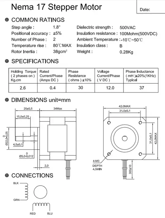

This is the stepper motor that i will be using it is rated at 12V. However, I plan on running it at 5V to conserve battery life (important as the device is portable and Will send data via WiFi). I was also informed that connecting the battery directly to the drivers enable pin will waste battery life (shown in the figure below) and that I should connect all of them directly to a single GPIO of the micro controller (bearing in mind that I am using two motor drivers, so 1 GPIO to 4 Enable pins).

I'd suggest that Nema sized stepper motors of any type would be completely unsuitable for this application. They are heavy and require large currents, which are difficult to supply in battery equipment particularly.
Stepper motors such as these will also NOT be able to move in 5deg steps without microstepping ....and you don't want to go there with a simple controller.
If you really want a stepper motor, then consider the 28YBJ-48 5V stepper (2048 steps per rev), which is readily available at low cost. This really needs to run on 12 V to be effective (because of the voltage drop in the driver) unless you change the ULN2003 type driver to a TPL7407L in which case you can get down to 9 V. The high gear ratio and the fact that it's driven x1 may be enough to hold position when powered down. Though I'd suggest whenever you power up you need to seek a home flag for each axis in the pan and tilt.
