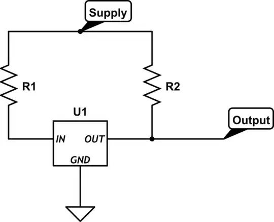

Here's a circuit using resistors to augment the regulator.
schematic
R1 will absorb power when the circuit is drawing current, but it drops the input voltage to the regulator -- when you start pulling enough current that the input drops below the output voltage + dropout, then your regulator will fall out of regulation.
This means that you need to size R1 appropriately for the maximum current draw and the minimum supply voltage.
R2 will deliver current to the output, but it will always do so. This means that if the output circuit draws less current than R2 can deliver, the output voltage will rise above the regulated value.
This means that you need to size R2 appropriately for the minimum current draw and the maximum supply voltage.
