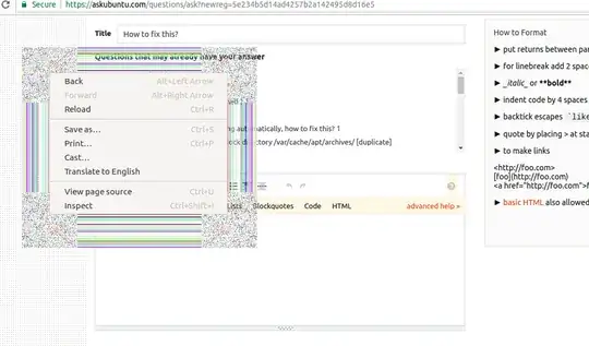

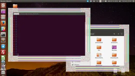

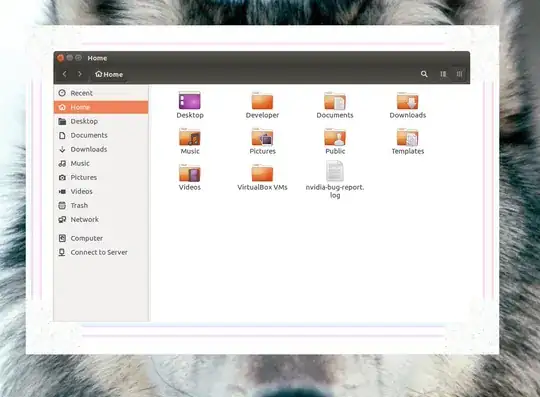

Upon waking up Ubuntu 16.04 from Suspend, the following graphical glitches appear around all windows, context menus, and similar:
This is currently known to affect the following NVIDIA cards running the proprietary drivers:
  • NVIDIA GeForce 610M, driver version 375.39, 340.102
  • NVIDIA GT 630M, driver version 375.39
  • NVIDIA GTX 650, driver version 375.39
  • NVIDIA GT 740M, driver version 378.13
  • NVIDIA GTX 745, unknown driver version
  • NVIDIA GTX 850M, driver version 375.39, 378.13
  • NVIDIA GT 940M, driver version 375.39
  • NVIDIA GTX 950M, unknown driver version
  • NVIDIA GTX 960M, driver version 378.13
  • NVIDIA GTX 970, driver version 375.39
  • NVIDIA GTX 970M, driver version 375.39
  • NVIDIA GTX 980 TI, unknown driver version
  • NVIDIA GTX 1060, driver version 375.26, 375.39, 378.09
  • NVIDIA GTX 1070, driver version 378.09
The above above list has been sourced from reports from other users here on AU, this thread, and this thread.
NB: This is be no means an exclusive list. It probably effects nearly all Nvidia cards.
Furthermore, this issue has been replicated on a clean install where the only change was a software update and the installation of the latest NVIDIA drivers.
What is going on, and how can it be resolved?

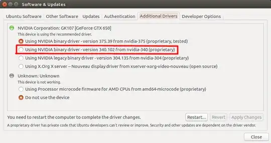

  • If you are on the legacy driver, then you should perform a:
    sudo apt-get update

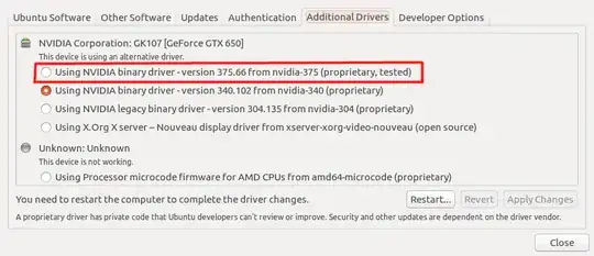

    Followed by switching to the new driver version in Additional Drivers:
  • If you are currently using a manually installed driver, you should uninstall it, reboot, and then perform the steps outlined above.
After rebooting, you should find that your Nvidia driver has been updated to 375.66.
2. If you don't need the newer driver for compatibility with your GPU:*
*Note that this section has been superseded by section #1

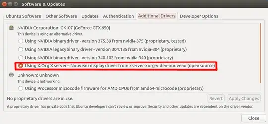

If your graphics card is old enough that it is supported by v340 of the driver, there is no need to install a newer version from an unofficial PPA. For people with newer cards like the GTX 9-series or 10-series however, you will need a newer driver.

So, if your GPU is supported by 340, then you can simply switch to version 340 in Additional Drivers. (Version 340 does not have this bug.)
Be sure to reboot after switching the driver version.

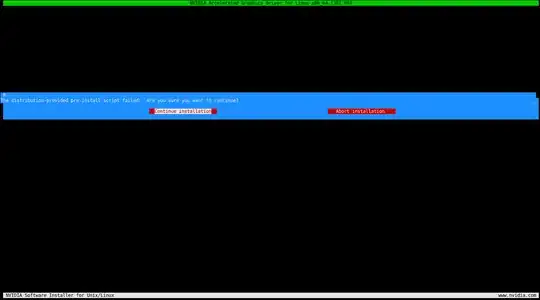

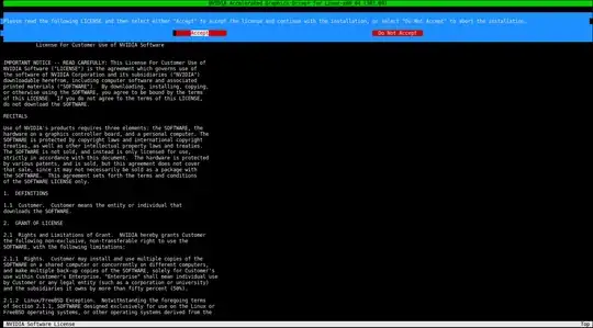

  7. Accept the license agreement:
  8. It will complain that the distribution-provided pre-installer script failed. Continue anyway:

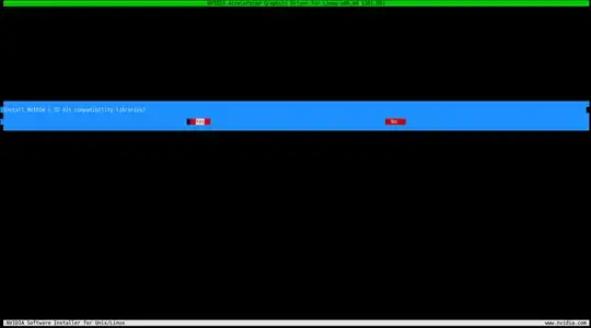

  10. Select Yes when asked if you'd like to install the 32-bit compatibility libraries:

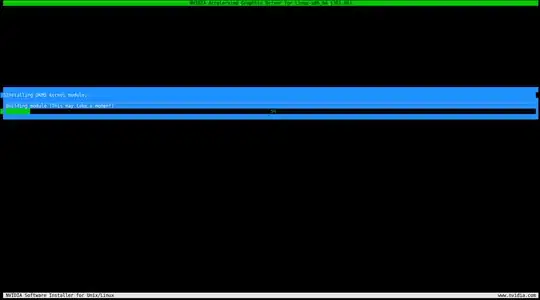

  11. It will take a while to build the kernel module, so be patient!

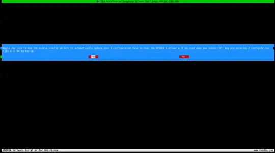

  12. Select Yes when asked if you'd like to run nvidia-xconfig:

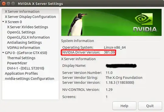

  15. After your computer reboots, open Nvidia X Server Settings. With any luck, you'll see the new driver version:

NVIDIA has released an updated driver version that has fixed this regression. Any driver past 381.09 will now no longer have this issue, until NVIDIA messes up again.
Until such time as the driver reaches the main repositories, they can be downloaded from the unofficial NVIDIA driver PPA. Doing this ensures that you won't need to mess with the installer (which is widely considered a bad idea) or Nouveau. Similarly, it will allow the drivers to be installed/uninstalled through apt instead of the dangerous half-configuration the NVIDIA installer leaves drivers in. Furthermore, this will not cause any login loops or errors unless you have a weird system. To install, run:
sudo add-apt-repository ppa:graphics-drivers/ppa
sudo apt update
sudo apt install nvidia-381
The old drivers will automatically be uninstalled and the new ones will be loaded in. Follow up by rebooting your computer (as NVIDIA drivers need to be baked into the kernel), and everything should work just fine. You can check that the drivers were installed correctly by running the below command:
nvidia-settings --version
Be sure to revert any patches described in this post before you update to the latest drivers. For example, if you installed the patched version of Unity as described below, run this command to revert back to the normal version:

This problem has also been fixed in the Nvidia 375.66 driver, which is in the normal repositories, and should be installed by the normal updates.
