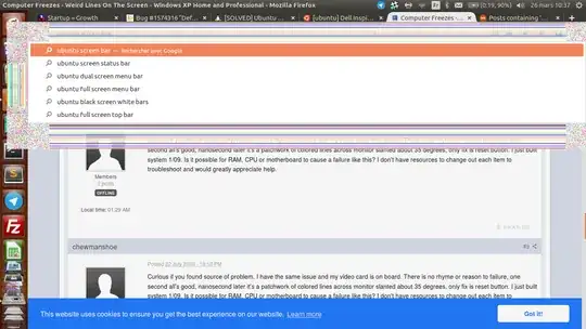

Two days ago, after putting my computer for less than one hour in sleep mode, I noticed weird lines of different colors around all windows as you can see on this screenshot:
Around all windows, active or not
Lines are both horizontal and vertical, from different colors, they look like barcodes and on the edges horizontal and vertical lines are scrambled. Those lines appear whether the window is active or not, in the foreground or not.
The lines also appear on the "X" "-" "|_|" icons on the top left hand corner of each window.
The bug also happens in search results in Chrome for instance, actually in any input field with autosuggestion on an HTML webpage:
In Chrome search results
It also happens when a context menu is open. For instance after a mouse right click there are lines all around the menu.

As Rafal said it's a known bug that should be fixed with the next release: https://devtalk.nvidia.com/default/topic/990898/suspend-corrupts-window-manager-after-upgrade-to-378-09/?offset=30
In the meantime I solved the bug by restarting compiz: compiz --replace
Another solution is to downgrade to the previous driver version ( https://askubuntu.com/a/896544/657603 ):
