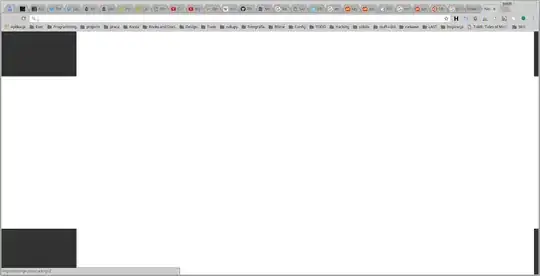

I've installed Xubuntu 16.10 with Nvidia binary drivers on ASUS ROG GL552VW and when I run chromium I got this look, it don't change when I enter different url in address bar.

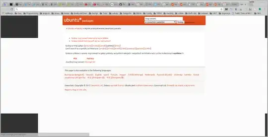

When I opened the browser It opened last open tabs and when I switch I got the page but it don't change when I switch back to new tab (I have the same gray rectangles and the previous page)
Anybody had the same issue and resolve it?

I've resolved the issue by removing ~/.config/chromium directory.
