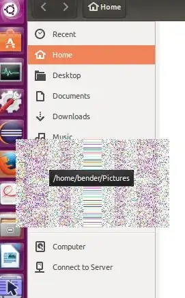

I faced strange issue, as usual after wake up (during work), every popup window (menu, list and etc) appeared with with a border like on the picture. Ubuntu 16.04. Only relogin or restarting helps. It never happened before this week.

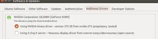

I made some steps which solve my problem, but don't know what exactly helps 1. I change driver to X.org open source from NVIDIA enter image description here
  1. Install all system updates
  2. Restarted OS, issue didn't occurred after it...
I hope it helps me... After it I tried to returned NVIDIA drivers... and it works well.. may be video drivers was corrupted.
