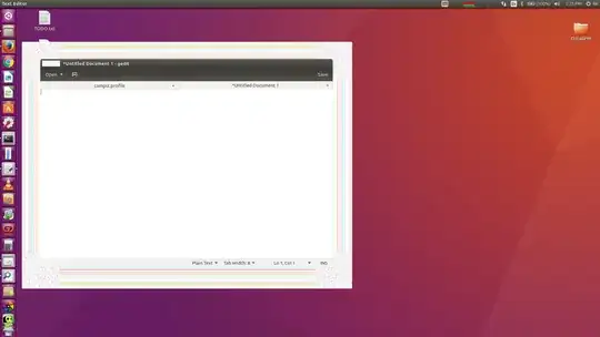

To create this, all I have to do is suspend my laptop and bring it back up again. At this point once I login back, the drop shadow on all the windows become messed up (see image). The corners (of the drop shadow) have some pink static noise and the borders form random lines.
Messed up drop shadow
This happens on all the application windows. If I reboot the laptop the problem goes away and promptly appears the next time I suspend/resume. This is same fate for newly opened windows.
