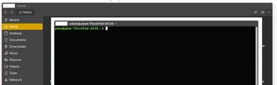

Out of the blue I started getting these weird borders around my windows. It either happens after coming back from full-screen applications, or after system resume. A reboot fixes this problem, but only temporarily. I have not updated my graphics drivers (not manually, automatically maybe) or had any problems since installing last year.
My video card is a NVIDIA Quadro K1000M, and I've been using NVIDIA binary driver version 375.39 since launch. I have not yet tried tinkering with the drivers, seeing if it would fix the problem or not.
image of white borders

The culprit is the new version of the NVidia driver. Reverting to 375 doesn't work because IMHO it has also been updated (minor version) and/or its dependencies are a mix of several versions. Anyway:
  1. Remove the PPA. On my computer I deleted the file /etc/apt/sources.list.d/graphics-drivers-ubuntu-ppa-xenial.list pointing to the repository deb http://ppa.launchpad.net/graphics-drivers/ppa/ubuntu xenial main
  2. Remove all the installed NVidia packages, i.e. nvidia-*. On my computer I deleted several packages with apt remove nvidia-361 nvidia-375 nvidia-378
  3. Update the packages list with apt update
  4. Install the last official version (i.e. 367) with apt install nvidia-367
As a side note, I'm always amazed how updates regularly break Ubuntu...

Its' not a solution per se, but it helps to get the white borders removed.
We just need to restart the Unity, by using the following command -
unity --replace,
which will restart the Desktop Manager, but will keep are current Session intact.
So no logout/login needed, just call the above command whenever these NVIDIA drivers create your screen unusable.

Above Solution was a temporary one... As it is true that latest drivers of NVIDIA breaks Ubuntu... I guess u should try the solution in the following link - Strange artifacts along window borders
As nvidia-367 updates itself automatically to nvidia-375, we need to get a stable nvidia-370, which doesn't update itself. This solved my issue, but I am still not convinced, as I still get screen tearing when watching a high-res video...

Updating the Nvidia driver to 384.69 solved the issue for me.
In "Software and Updates" open "Additional drivers" tab an there should be "nvidia-384" option available. Select->Apply Changes->Restart
If not then visit: http://www.nvidia.com/object/unix.html
