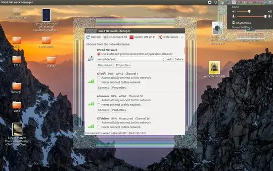

I recently upgraded from nvidia-370 to nvidia-375 as part of my efforts to install CUDA/Tensorflow, but I'm now getting a weird bug. Upon resuming from sleep, these glitchy borders appear around all windows and menu elements.
I've had bugs like this before, but the " pressctrl + alt + f1 and then ctrl + alt + f7" method, which worked with other sleep bugs, doesn't fix this problem. Does anyone know of a solution to this, or is my only option to downgrade to the 370 driver? I'm running 16.04 on kernel 4.4.0-62-generic

I found that restarting the window manager with
unity --replace
fixed this, although some windows crashed (Chrome for example) in the process.
Restarting compiz mighty also work, though I haven't tried it.
Edit: compiz --replace seems to work better for this, with little or no window crashing.

This bug is already logged on Launchpad Someone suggested a temporary fix which worked great for me and that I reproduce here:
Create a file /lib/systemd/system-sleep/fixborders with the editor of your choice with root permissions. (If you don't know, just type gksudo gedit /lib/systemd/system-sleep/fixborders in a terminal) with the following content:
#!/bin/sh
kill $(ps -C compiz -o pid=)
Give that file excutable permissions:
sudo chmod +x /lib/systemd/system-sleep/fixborders
Et voila!
