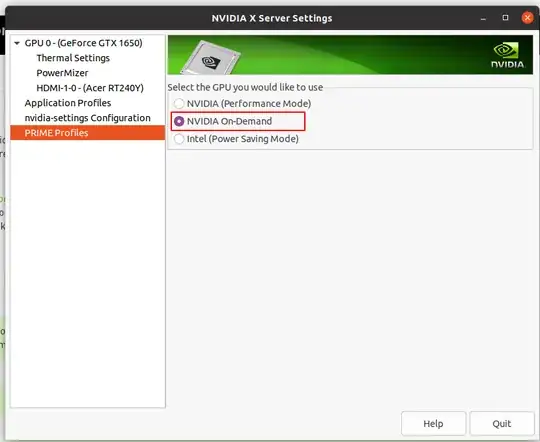

Change the settings to the NVIDIA On-Demand.I just changed it and issue resolved.
