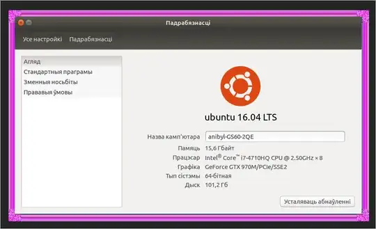

After resuming I have a graphics issue with textures (not sure, see screenshots).
Windows frame:
about window
Viber app:
viber app
Also some other apps are affected.

Unity reload (Alt+F2 → unity) helps, but it crashes the most of open apps.
Any suggestions?
UPD: seems like it is bug of NVidia card/driver (reproduced with nvidia-367, nvidia-370, nvidia-375, nvidia-378).
