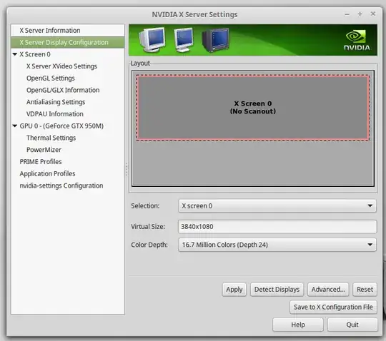

I also post a screenshot that shows that the two monitors are not detected correctly.
