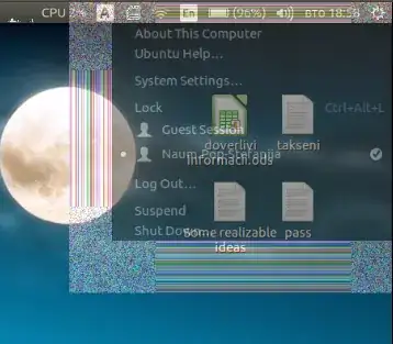

Yesterday I made some system updates, and after that my ubuntu shows mixed colors around every new opened window. I tried to remove the latest update but it doesn't solve the problem. When I reboot the system, mixed colors disappears until the first suspend or hibernate. Here is an example of new opened window:
"mixed color" border of settings

The bug is also reported here: https://devtalk.nvidia.com/default/topic/995750/linux/375-39-causes-corruption-of-window-decor-on-ubuntu-after-suspend-resume/
The next release should fix this problem. The temporary fix described here works for me:
echo -e '#!/bin/bash'"\n## This file (or a link to it) must be in the folder /lib/systemd/system-sleep/\n## Purpose: Kill compiz after system wakes up from sleep.\n## This will fix bad window borders caused by Nvidia driver 375.39.\nkill \$(ps -C compiz -o pid=)" | sudo tee /lib/systemd/system-sleep/fixbadborders
sudo chmod +x /lib/systemd/system-sleep/fixbadborders
