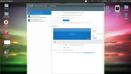

Yesterday, I added the Sane PPA (scanner drivers), aptitude update+upgrade, and then rebooted when it prompted me to. The reboot didn't finish (it just sat there on the screen with "Ubuntu" and the red/white dots for 15ish minutes), so I power cycled the machine.
Now I see what looks like uninitialized video memory where the window shadows and corner buttons should be:
visual noise instead of shadows
I'm on a Dell XPS 15" with an NVidia 960M, running the graphics drivers PPA (nvidia-375 375.39-0ubuntu0~gpu16.04.2), otherwise pretty stock 16.04 in terms of packages.
I can dig up logs of what packages exactly got updated with yesterday's aptitude upgrade, if it's relevant.
My questions:
  • Is this a known issue?
  • Is there a workaround or fix?
  • If not, where is the best place to report the bug?

I have the same. There is a bug.
https://bugs.launchpad.net/ubuntu/+source/compiz/+bug/1292830
It took me awhile to find it. A quick workaround:
compiz --replace
I can confirm this bug.
A screenshot showing the glitch/bug
I also have a Nvidia graphics card, a Geforce 440M (not the optimus version)
Using any of the Nvidia drivers results in shown bug. Usually it happens after waking from sleep, some times after some application goes full screen.
I can answer your question though. How do I get rid of the glitching borders, shadows and buttons? Easy. Go to unity tweak tool -> themes, then pick another theme, and then your current theme again, then close the window. The glitching is gone. (At least for me)
This is not a definitive solution, as glitching may happen again on the same session. If it does, just repeat the process I stated.
I know this is not an answer, but may help to shed light into the issue.
