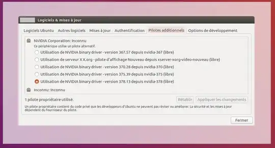

My system updated the long lived branch Nvidia drivers to 375.39 yesterday. The problem is that now, when the computer goes to sleep, then wakes up, some windows are buggy:
The same happens with terminal windows. I tried the short lived branch latest drivers, the 378.13, it is the same problem. What can I do ?
Update: Now the drivers 375.39 are the official Nvidia drivers available from the Ubuntu repository, yet the bug evoked above is still there.
