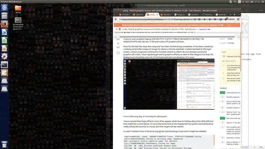

Now for the last few days the computer has been misbehaving somewhat, it has been randomly crashing where the computer hangs for about a minute and then crashes me back to the login screen, certain programs continue to function where as others do not (mostly sound and graphics all crash). I also regularly get weird graphics effects as seen in this image (note that the background should be a bunch of formulas and text not whatever it is now) picture of weird graphics artifacts

Alright my computer broke completely and has been returned to acer, turns out the motherboard and screen had to be replaced. That suggests this was an early warning of breaking hardware.
