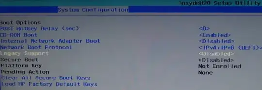

I had the same problem, I updated my driver just as explaind in Pilot6 answer , but it still frequently disconnected. I was desperatly searching for another solution when I found in laugeo's answer that removing Windows 10 fastboot solves the problem. Unfortunalty, I only have Ubuntu and no Windows. However I found that simply disabling Legacy Support solves the problem!
I had to go to disable Legacy Support in Bios like this:
Bios -> Boot Option (Enter) -> Legacy Support: Disabled
Now WLAN works perfectly - no more disconnects!
