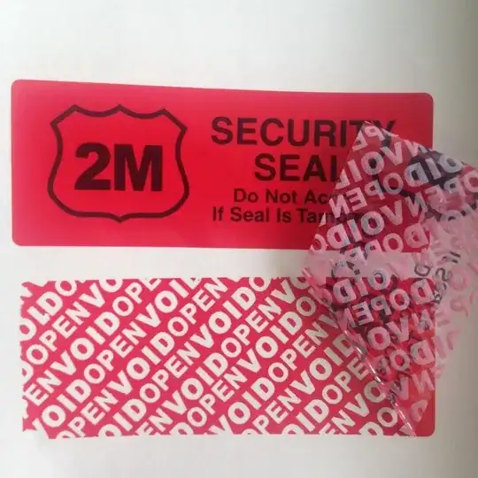

Any computer which an attacker has physical access can be tampered in less than 5 minutes, having it secure boot or not. An attacker can inject a keylogger directly to the board or CPU by using a special device.
Also Secure Boot disables the use of kernel modules, and it's incompatible with most Linux distributions.
As result what I do is keeping it turned off, and instead pasting a secure sticker on the case in a quite noticeable place.
That along with keeping the UEFI password protected by a simple six digits PIN, and configured to only boot from the internal storage.
https://sc01.alicdn.com/kf/HTB1.5dUav9TBuNjy0Fcq6zeiFXa3.jpg
