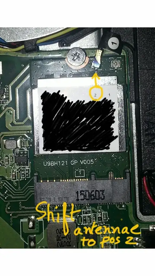

I bought a new laptop a few weeks ago and had the same problem, then I found https://github.com/lwfinger/rtlwifi_new/issues/28 and change the antenna position as Ghost says.
Here is the picture he adds to guide you (the antenna was connected to the pin on the right side) now my wifi works correctly.
http://i65.tinypic.com/vql568.jpg
I know its late, but just in case anyone else has the same problem can try this solution.
