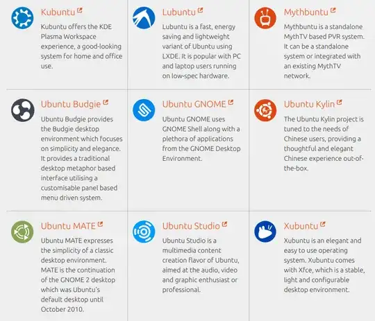

What are the default text editors (GUI and CLI) in different flavors of Ubuntu. what commands should we use to edit files with them?
screensho
Behind the question
I tried Kubuntu and want to try more Ubuntu flavors and other distros, but when I was in Kubuntu I tried so hard to run gksu gedit /path/file.txt which wont work because gedit isn't the default text editor in Kubuntu, it's kate. I'm glad nano was available. but if I want to try more flavors I must know what are the default text editors in various Ubuntu flavors
