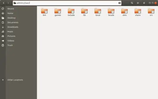

Use the GVfs admin backend, just add admin:// to the beginning of the full path to your preferred directory.
Open Nautilus the usual way and press Ctrl+L to enable typing in the address-bar, and then enter for example admin:///usr/ to open the /usr/ directory.
Enter your admin password when prompted and you will see something like this:
At this point clicking on the folders with locks will open with admin privileges.
You may bookmark a folder that is opened with admin:/// prefix. When you click on such a bookmark later you may be prompted for the admin password again.

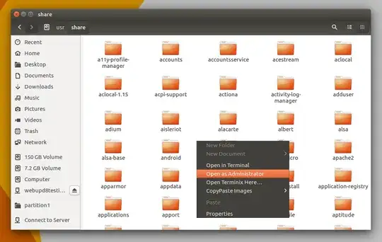

Nautilus admin adds PolicyKit files for both Nautilus and Gedit and it allows opening a file or folder from Nautilus as root, via PolicyKit:
To install Nautilus Admin in Ubuntu, open a terminal by pressing Ctrl+Alt+T and use the following command:
sudo apt-get install nautilus-admin
And to restart Nautilus use either of the following commands:
nautilus -q or killall nautilus
After this when you right click on a folder you will see:
If you right click on a text file editable by Gedit you will see:
Then you will be prompted for password:
