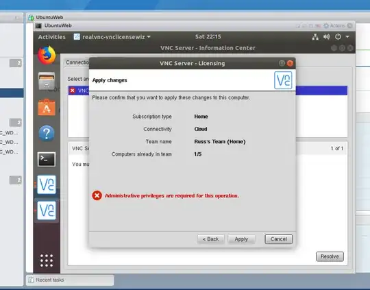

This tells me I need to login with my account, all expected stuff. However, once done authenticating with my account information, and picking a password for connecting to this particular machine, I am presented with:
I'm extremely new to ubuntu and linux in general, I just mostly want a cloud hosted way to track the machines I can remote into, which is why I was using realVnc (and it came with my pi)
Anyone have any idea what I need to do to provide admin privileges?

real vnc uses gksu to get administrative privileges Ubuntu 18.04 has not gksu [Why is gksu no longer installed by default?
you can install it following the method explained in this link [How to install an application that requires gksu package on ubuntu 18.04?
Once done, you will be able to manage the interface
From other pc, windows, start putty + xming app (x11 enabled) ssh to linux, login user, than start in console: vnclicensewiz, connect realvnc email+passwd than vnc passwd (2x), ok -> (need root passwd) work!
