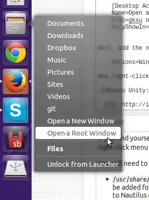

To add the option to run as root to the nautilus (Files) launcher:
  1. Copy the .desktop file, representing nautilus in the launcher, from the global directory /usr/share/applications to ~/.local/share/applications
    which is on 14.04 and 14.10 : nautilus.desktop:
    cp /usr/share/applications/nautilus.desktop ~/.local/share/applications
    and on 15.04 and 15.10 : org.gnome.Nautilus.desktop
    cp /usr/share/applications/org.gnome.Nautilus.desktop ~/.local/share/applications
  2. Open the file with (e.g.) gedit, look for the line:
    Actions=Window;
    Change it into:
    Actions=Window;Open as root;
    Add to the very end of the file:
    [Desktop Action Open as root]
    Name=Open as root
    Exec=gksu nautilus
    Save and close the file.

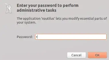

  3. Install gksu, to be able to enter your password via GUI:
    sudo apt-get install gksu
  4. Finally, log out/in to make Unity "aware" of the local, edited .desktop file.

Use pkexec instead of gksu
The use of gksu and gksudo is not recommended any more. The recommended method is to use Polkit. The easiest way to add Polkit files for Nautilus is to install nautilus-admin
To install nautilus-admin in Ubuntu, open a terminal by pressing Ctrl+Alt+T and use the following command:
sudo apt-get install nautilus-admin
The rest involves editing the `nautilus.desktop file and adding the correct command:
  1. Copy the nautilus.desktop file, representing nautilus in the launcher, from the global directory /usr/share/applications to ~/.local/share/applications
    Actions=Window;
Change it into:
Actions=Window;Open as Administrator;
[Desktop Action Open as Administrator]
Name=Open as Administrator
Exec=pkexec nautilus
The added bonus of installing nautilus-admin is that within Nautilus you will also get Open as Administrator / Edit as Administrator items for folders / text files in the right click context menu. See How do I start Nautilus as root? for more details.
