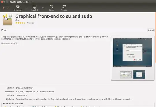

Otherwise check Ubuntu software center, open up Universe, update the sources and you can install it from either USC...
... or from command line with
sudo apt-get install gksu
