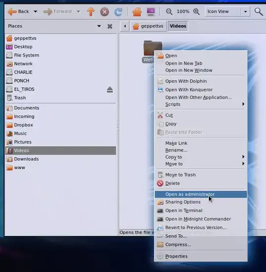

Additionally, you can achieve to open files/folders as root with a single click by using the "Open as Administrator" option via right click. Which in any case will open a new nautilus instance for the given folder and will open files as root, this may also open/run applications as root but I haven't tested it yet.

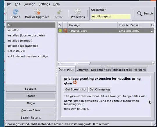

You can get the "Open as Administration" option in your contextual menu by installing nautilus-gksu via command line: sudo apt-get install nautilus-gksu or by using synaptic as shown in the next image:
