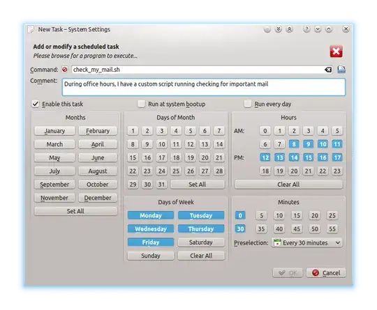

I recommend KDE's Task Scheduler (kde-config-cron) Install kde-config-cron. Access it from the System Settings in the Task Scheduler module there.
It manages both personal and system Crontabs, and the ease of creating the time boundaries greatly surprised me (see the screenshot below). I think this part is really underrated.
