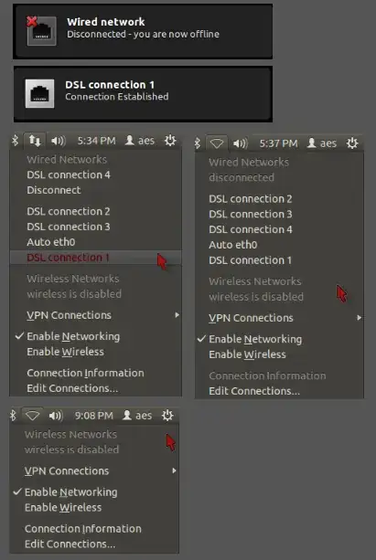

Using Ubuntu 11.10 (Unity 3D) and a cable (DSL) internet connection with no router or modem.
If I disconnect my internet connection, I can just reconnect by clicking on the network manager icon and selecting a connection from the drop down menu since my connections are visible. There is no need to restart network manager.
But whenever the internet connection drops by itself, I have open a terminal and use sudo service network-manager restart since I don't see any connection in the network manager drop down menu. Only after the command, does network manager then start and automatically connect.
Is there some setting so that network manager does not have to be restarted each time the connection drops (as opposed to my disconnecting it when it doesn't need a restart)?
I guess in other words, I don't want network manager to stop as long as I'm using the computer, irrespective of whether my connection to the ISP has dropped or not.
It's not a very big deal to open a terminal and type the command and password, but if there's a way to ensure that network manager doesn't stop that would be better.
