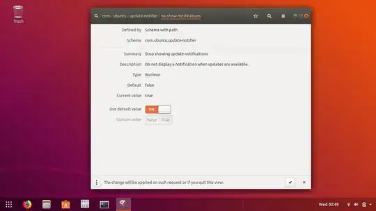

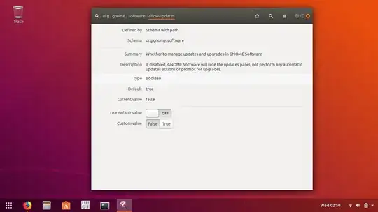

Please have a look on below images.
to access in your system please install dconf-editor.
to install it sudo apt update && sudo apt install dconf-editor
enter image description here enter image description here enter image description here

Based on your needs you can control those three choices with command line as below commands
gsettings set com.ubuntu.update-notifier no-show-notifications true
gsettings set org.gnome.software download-updates false
gsettings set org.gnome.software allow-updates false
now, Based on your needs, you can set cronjob (How do I set up a Cron job?) with true and false values for your chosen time..
for example. 6pm to 10pm is the PRIME TV PROGRAMME,
then set the 3 values scheduled at 6pm true/ false
and then set the 3 values scheduled at 10pm false/ ture
