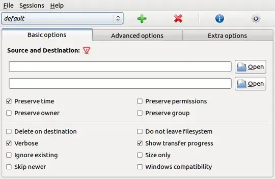

If you prefer a GUI you can use grsync Install grsync:
grsync
When you configured it to your needs, press Alt+R to display the correspondent command line.

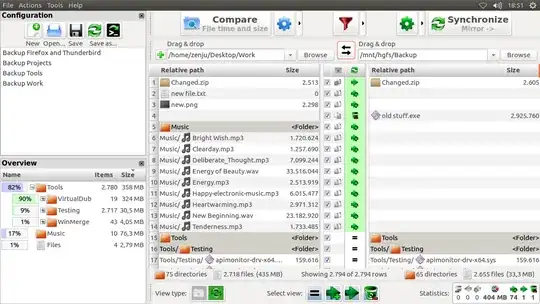

I can recommend FreeFileSync. It works fast and great.
FreeFileSync on Ubuntu
I'm using it for synchronization between HDDs, USB-flashes, SSHFS, Samba share and/or local folder.
Also it has real-time sync mode (named as RealTimeSync).

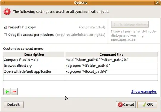

It works great in conjunction with Meld (sudo apt-get install meld).
You need to open FreeFileSync options (Tools→Options) and then add the following to the first line:
 |        Description       |             Command line            |
 |  Compare files in Meld   |  meld "%item_path%" "%item_path2%"  |
as shown on screenshot:
FreeFileSync Tools→Options
