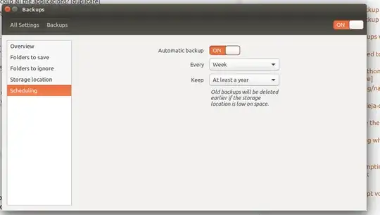

I'm using Déjà Dup to backup my disks into a cloud disk, but it's not accessible 24/7 (long story). When it tries to connect and it's not accessible, Déjà Dup gives an error, and in the next time it cannot connect again (I suppose the file system disables this cloud disk).
Is there a way to setup on which time Déjà Dup makes the automatic backup? Where are the cron job files/tasks? May I changed them manually?
