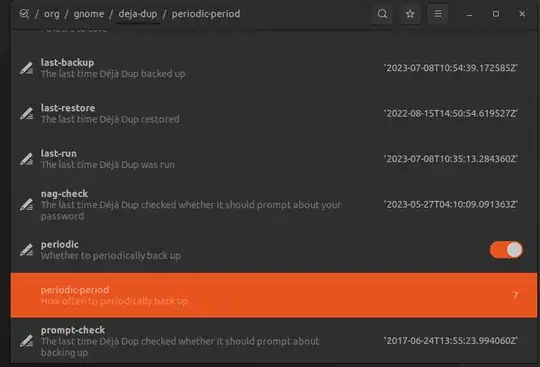

I also tried to manipulate the settings under org.gnome.deja-dup using dconf-editor (as suggested by launchpad bug #479191 "Detailed scheduling"):
Altering all the dates under org.gnome.deja-dup (to have happened on another weekday) changes nothing.
I also tested changing periodic-period. It seems to affect the days until the next backup. From this I conclude that the next backup date is always calculated from some date I cannot change. My best theory right now is that it uses 1970.01.01 00:00. That's also a Thursday and weekly backups seem to run on a Thursday morning for everyone.
dconf-editor: altered values under org.gnome.deja-dup
