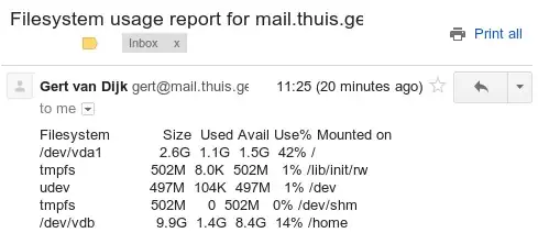

Provided you have an MTA configured on that machine to accept and relay mail for you (on a server that should be the case) try this:
$ df -h | mail -s "Filesystem usage report for `hostname`" myemail@domain.tld
(MTA = Postfix, Exim, etc.)
Example emailed report
