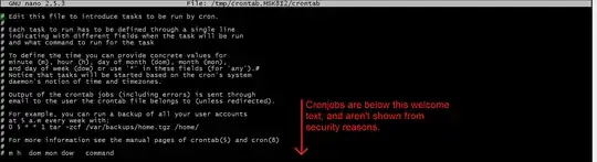

A few hours ago I just created a fresh VPS environment and right on the start did crontab -e, pasted my cronjobs from a file, and saved.
I did crontab -e a few minutes ago and saw that the file name is:
/tmp/crontab.MSK8I2/crontab
Why is that? Thx,
Running crontab -e edits users' crontabs (rather than the system crontab /etc/crontab). If you run sudo crontab -e, this edits the root account's user crontab (which is not the same as /etc/crontab). The root account's user crontab is usable, but is often not what system administrators wish to edit.
When you run crontab -e, the crontab utility copies the particular user-specific crontab file being edited to a temporary file. This is the intended and correct behavior. Assuming you make changes to the temporary file in the editor, crontab then automatically writes those changes back to the crontab file after you finish editing.
Braiam has explained some details as to why and how this is done in "Cron, crontab -e reads the wrong file" on Unix.SE:
That's the default behavior. crontab -e would copy the crontab file to the temporary directory, then use the editor listed in VISUAL or EDITOR environment variables to open this file, when saving, it would then try to copy the file to the original location. This is an atomic operation.
The reasons behind this are varied, from preventing two users to edit the same file at the same time to have a sanity/syntax check before writing the original file.
Ah, the crontab -e also do not trim the file in any way, unless you use Debian.
The screenshot in your question shows something very much like this, which is the default commented text of a user crontab in Ubuntu:
