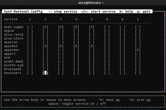

sysv-rc-conf
Try using sysv-rc-conf
sudo apt-get install sysv-rc-conf
and to start managing the services, execute
sudo sysv-rc-conf
Which will bring up interactive window like this
You can further navigate through pages using Ctrl+n for next page and Ctrl+p for previous page. You can enable and disable services by selecting SPACE on desired runlevels.

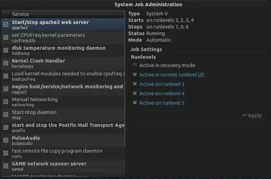

Jobs-Admin
Another alternate would be Jobs-Admin by installing through
sudo apt-get install jobs-admin
Which also provides GUI like this
jobs-admin preview
For showing more jobs , you have to tick the Show Protected Jobs from its menu.

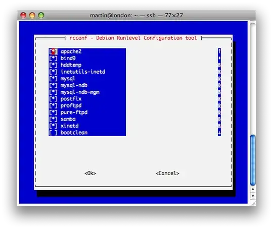

For those of us who run Ubuntu over ssh, I think the nicest option is rcconf - a text based program:
sudo apt-get install rcconf
sudo rcconf
alt text
Navigate with tab and arrow keys, press spacebar to enable/disable. Changes are persistent across restarts.
Screenshot borrowed from this blogpost, which also shows sysv-rc-conf - a similar tool that also lets you set the runlevel. (For those who happen to care enough about runlevels to wish to change them :)
Unfortunately, rcconf doesn't work with upstart (services listed in /etc/init/*), just with the traditional mechanism (ls -l /etc/init.d/* - the ones that are not symbolic links).
Fortunately, many of the services that are relevant when ssh-ing in to a server (Apache, Tomcat, mdadm, boinc-client...) haven't been moved to upstart yet.

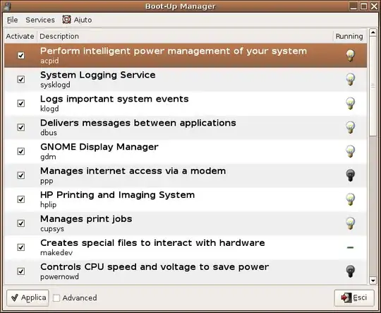

There is also the Boot-Up Manager.
To install: sudo apt-get install bum
Further info: http://www.marzocca.net/linux/bum.html
