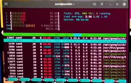

After a few days of installation of Ubuntu 20.04 on my Desktop system, I am facing this issue of my OS freezing at random intervals. Happening 2-3 times a day.
The question may be similar to this one but the those answers are not applicable because I already have 16 GB of SWAP and a recent kernel version.
I also checked many other similar questions but could not find the specific solution.
The picture of the htop, the last time it happened.
I checked the /var/log/syslog file and could not find anything relevant.
Screenshot of syslog file.
All the time it froze, I was using two browsers: Firefox(2-3 tabs) and Chrome(4-5 tabs, youtube in on of them) and a few other applications like Vscode, Terminal etc. I was not doing any heavy(memory-wise) work.

You have two different 8G memory DIMMs installed, and they're at different clock speed rates.
/0/1/0                     memory         8GiB DIMM DDR3 Synchronous 1333 MHz (0.8 ns)
/0/1/1                     memory         8GiB DIMM DDR3 Synchronous 1067 MHz (0.9 ns)
When installed in pairs, memory interleaving calls out that both DIMMs should be exactly the same size, access, and clock rates.
The memory spec for your ASUS H81M-K motherboard is:
2 x DIMM, Max. 16GB, DDR3 1600/1333/1066 MHz Non-ECC, Un-buffered Memory
Dual Channel Memory Architecture
Source: https://www.asus.com/Motherboards-Components/Motherboards/Business/H81MK/techspec/
Note: See https://www.crucial.com/compatible-upgrade-for/asus/h81m-k#memory for compatible memory DIMMs.
Go to https://www.memtest86.com/ and download/run their free memtest to test your memory. Get at least one complete pass of all the 4/4 tests to confirm good memory. This may take a few hours to complete.
Update #1:
Regarding different memory DIMMs, it may slow down to the slowest speed (which in your case is almost 1/2 speed), or it might get confused, but for memory interleaving to work, the DIMMs must be exactly the same. Removing the slowest DIMM, for testing purposes, would tell you if the freezing problems went away.
Update #2:
Check your BIOS with sudo dmidecode -s bios-version... it should be 3604. Get it at https://www.asus.com/Motherboards-Components/Motherboards/Business/H81MK/HelpDesk_BIOS/

If the issue is something that is occurring with some specific software or browser like Chrome, try disabling the hardware acceleration option in the software, I had a almost similar case and nothing helped but disabling hardware acceleration in Chrome seems to have fixed the issue.
You can check my issue here, Random screen distortion and freeze in Ubuntu 20.04/22.04
