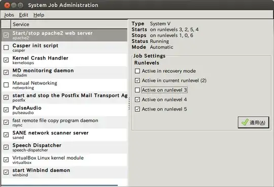

I forgot it, That program is in ubuntu official repositories
From my memory... That program have a [ ] box for tick # before each services.
It is not chkconfig, sysv-rc-conf, Thanks!

I think that is jobs-admin : A service administration and configuration UI.
Install: sudo apt-get install jobs-admin
Execute: sudo jobs-admin
