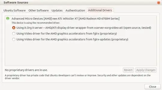

You might also want to check which graphics driver you have installed by opening software-properties-gtk and having a look at the "Additional Drivers" tab.
Using a proprietary driver tripled my battery life.
