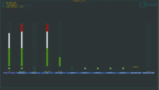

You will then be presented with a screen like this:
screenshot
Please, check if the speakers or any audio output is muted and unmute it.
MM means mute and OO means unmute.
Then exit when done by pressing Esc
