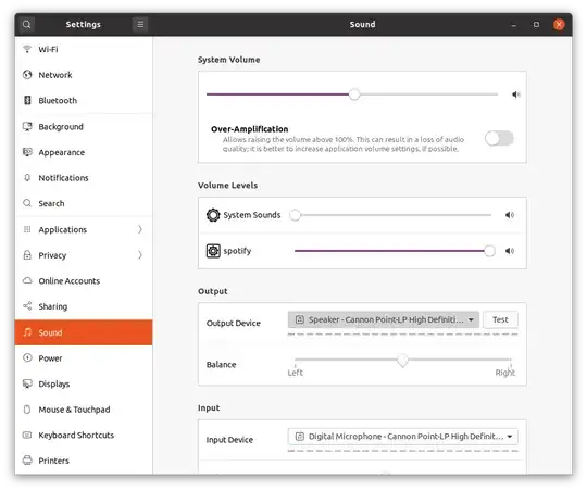

enter image description here Hello All,
On 18.04.4, there was only one output device. And when I inserted a headset, the sound was playing on headset automatically.
On 20.04 I am having to select output device as headphone when connecting earphone or headset.
Any suggestions?
