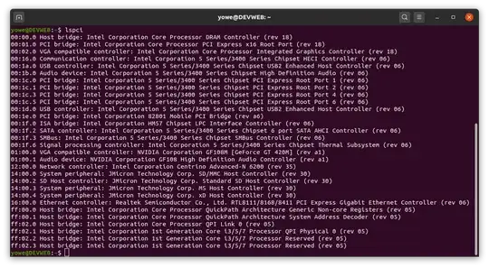

When I run lspci I have these results:
Devices

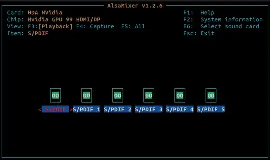

The first thing to do is to run alsamixer to make sure your hdmi device isn't muted. You should see a screen like the one below.
Use F6 to select the correct sound card. If you see MM in any of the slots, that means it's muted. Select it and press M to unmute. Hit Esc when you're done.
Really, you probably should only need to unmute one of these slots (the one actually associated with your hdmi port which is probably the first one), but it doesn't hurt to unmute them all.
