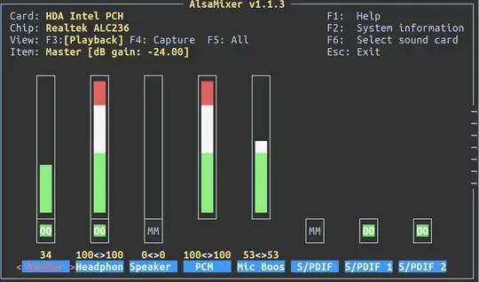

When I view settings in alsamixer I see: enter image description here

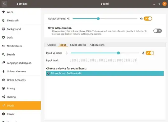

Similarly, in my sound settings I can see that the microphone is successfully detected, yet no levels are present enter image description here

You could try hitting F6 in alsamixer, which should show up a list of sound cards on your machine. Your mic could be one of those, and need the volume raising there too.
Likewise F4 from alsamixer for main input, which you may have done already, but is worth checking.
The mic on your second picture is the onboard mic not the usb one. Have you tried rebooting with the mic plugged in? My experience with external mics has always been nicer after doing that
